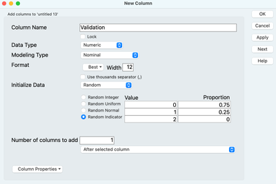

FWIW, another way to do this interactively is to select Cols > New Columns... from the main menu, then fill out the dialog as below:
