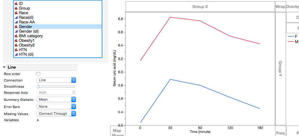

However when I tried your method using the Graph Builder, this is what I achieved before changing Smoother to line:Screen Shot 2018-08-28 at 19.49.45.png
And here is after: Screen Shot 2018-08-28 at 19.50.06.png
I am stilling getting only 2 lines (one for women and the other for men), instead of 50 lines. Do you know where could I have done incorrectly?
txnelson
Re: How to make a line graph containing multiple lines?
Overlay by the ID column, not the gender column.
Jim

Just a follow-up question: I am trying to separate women from men on this graph (which we intend to make only black and white) by assigning solid lines to women and dash lines to men. But apparently the "Color" on Graph Builder wouldn't let me do so, it only changes color. Screen Shot 2018-08-28 at 20.34.31.png
