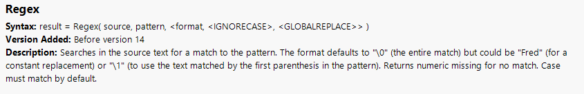

There is also IGNORECASE flag in Regex in JMP, but still I would suggest using other methods than regex if you just want the filename (or extension or both)
Names Default To Here(1);
path = Convert File Path("$SAMPLE_DATA/Big Class.jmp");
filename1 = Regex(path, "(.+\/)*([^\/]+)\.(JMP)$", "\2", IGNORECASE);
filename2 = Word(-2, path, "\/.");
filename3 = Word(-1, path, "\/");
Show(filename1, filename2, filename3);
Regex(source, pattern, (<replacement string>, <format, "GLOBALREPLACE", "IGNORECASE">>)
Scripting Guide > Types of Data > Regular Expressions > Regex Function
-Jarmo

Thanks @jthi .  I knew I'd seen this somewhere.  Of course it was in the scripting guide.  Ha.
