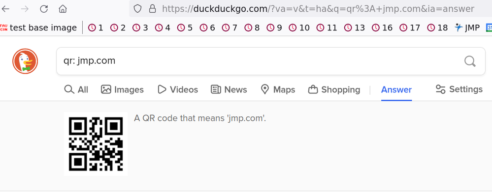

There are some good and bad choices for qr code generators on the web.
My favorite generator is the duckduckgo search engine, just type qr: https://example.com  as the search.
The string can be anything; typically you want the https:// part as well.The string can be anything; typically you want the https:// part as well.

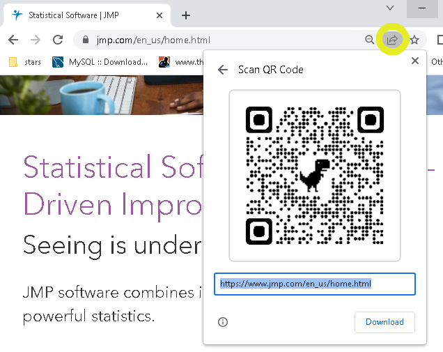

The chrome browser can also share a qr code.
Chrome needs higher resolution. I think the dino in the middle needs extra error checking.Chrome needs higher resolution. I think the dino in the middle needs extra error checking.
