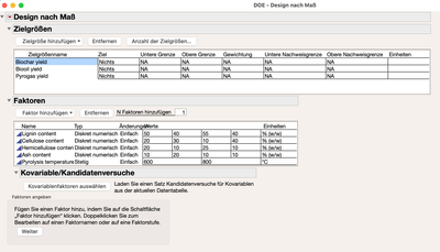

..so it would look like that :
Each column for the individual contents of lignin, cellulose, hemicellulose and ash would stand for one biomass.

jgrafmu2
Level II
Re: How to insert factors that are linked with each other in a DOE
Dear Victor,
thanks a lot! That is exactly what I was looking for.
