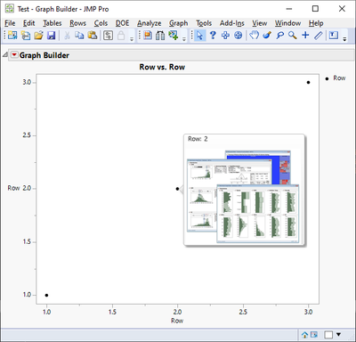

SampleTapir814
Level II
Re: How to hover over a point and see the image associated with that row
Thank you for the reply.  I tried to use this information but could not get it to work.  Can you please take a look at my screen captures and let me know if you see anything I may want to change.
