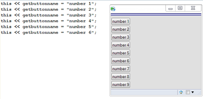

Re: How to generate buttons within a loop?
A button script can be a function with a "this" parameter that refers to the button, which means the button can find its name or its parent box.
New Window( "example", v = V List Box() );
f = Function( {this}, Show( this << getbuttonname ) );
For( i = 1, i < 10, i++,
  v << append( Button Box( "number " || Char( i ), Set Function( f ) ) )
The "Set Function" parameter is the key to making this work.  In your example I think the button names might be the column names.  The VListBox in the example is named "v" so button boxes can be appended to it.
Craige
