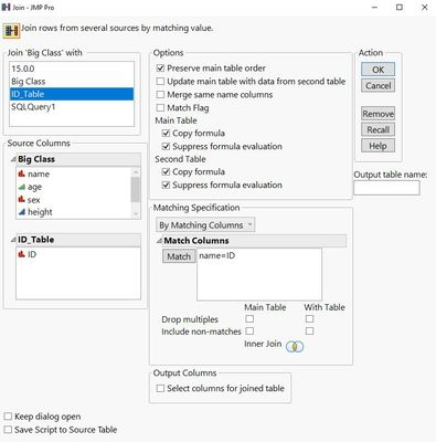

  2. In the table menu you have "Join" where you can do a database like join as you require it to be, like this e.g. JoinWindow.JPG
    3. Press ok and you'll get a shortened new table and can close the other two tables.

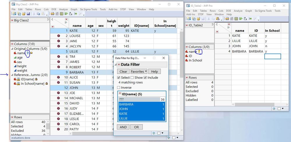

Similar thing you can achieve with the menu Tables -> JMP Query Builder, however there you have even more options like in a database Query Builder and you get besides the source script an update script and other options you can use to change options for query. (Attached an example to illustrate this (Big Class.jmp, ID_Table.jmp, SQLQuery1.jmp)
The other option allows you filtering on the fly: Using Linked/referenced tables aka virtual join. There you need in the referenced table a column with the same name as in the Big table for the id, and another column with the same content as the ID column of the small table (so actually twice the same ID column, just with different names. (Please take a look in the second example. In the small table you specify the ID Column with the same name as in the big table as Link ID (right click on the column and Link ID). In the big table you right click on the ID column and select Link reference and as reference you choose the small table. You get all columns of the small table now also visualized in the big table as hidden columns. Now you can filter through this second ID column which only has entries like in the small table. This will exclude all others and therefore only take those rows into account which are of interest, but listed in a different table.virtual join.JPG
