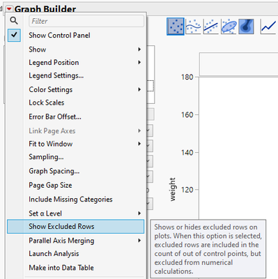

Then in graph builder, hold shift and click on red triangle to select show excluded rows
