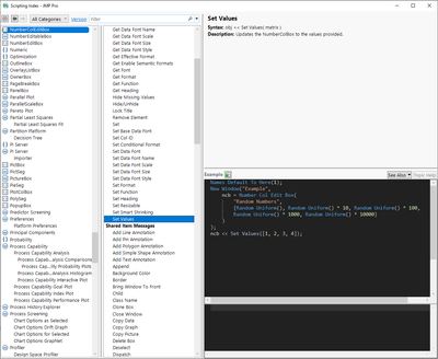

Hello,
I'm working on a project where I want to have users calculate values in a separate custom window that is then transmitted to the custom profiler to change the values held in their from the prediction formula in a data table. I'm stuck on trying to edit the NumberColEdit Boxes in the custom profiler, I can get the string list out, but not sure how to change the first string value and have it brought back into the box.
I have a simplified example here, where the custom profiler is created and a separate window is made with a button to press - I want this button to change the second value in the string list to '185' (in the actual final tool, the user will calculate a value in the second window that I want transmitted to the first X position in the custom profiler).
Thanks!

If you check Number Col Edit Box from scripting index you can find example. Set Values is one option
Buttonwind = New Window("Hello",
	Outline Box("Press the button",
		Button Box("Press me",
			new_value_list = value_list;
			new_value_list[2] = 185;
			bob << Set Values(Matrix(new_value_list));
-Jarmo
