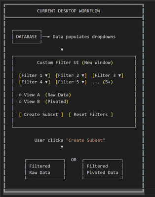

This is our current workflow and UI which we are using internally(locally).

Re: How to display dynamic Data Filter in JMP Live?

I am using the Latest JMP 19.
In my current UI which is not on JMP Live. We have custom conditional dropdowns which we are using as filters and we also have some radio buttons which we are using to decide what kind of subset we wanted to generate.
So filters(dropdowns)+ radio button = Subset Table (In simple words)
The data that we have is more than 50K+.
I tried Data Filter with Tabulate so it is extremely slow on JMP Live. I was wondering what other approaches/solution that I can try to achieve similar thing.
