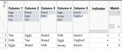

Here is a formula that will place a 1 in the indicator column if the combination of Bread and Yoghurt are found in a given row, and a 0 if not found

Here is one option using associative arrays and their set operations
Names Default To Here(1);
dt = Open("$DOWNLOADS/items.jmp");
list_to_search_for =  {"Tea", "Milk", "Bread"};
aa_mask = Associative Array(list_to_search_for);
dt << New Column("Match", Numeric, Continuous, << Set Each Value(
	aa_row = Associative Array(dt[Row(), 0]);
	temp_mask = aa_mask;
	temp_mask << Remove(aa_row);
	If(N Items(temp_mask) == 0,
		1
		0

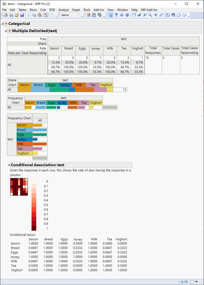

JMP's Consumer Research platform might also be helpful but I haven't used it so I'm not sure if it can look for such combinations as you need (Conditional Association might be helpful?)
