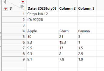

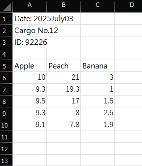

When using JSL and the Open() function to read a CSV file, if there are values in non-primary data columns above as shown in the image, how can I correctly read the values in the columns? Using Open() directly results in an error.
Additionally, if I need to read the IDs above the column data, how should I do that?

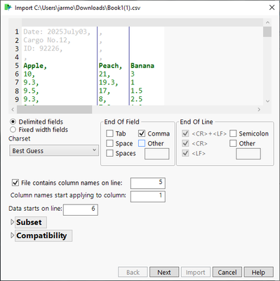

Using preview

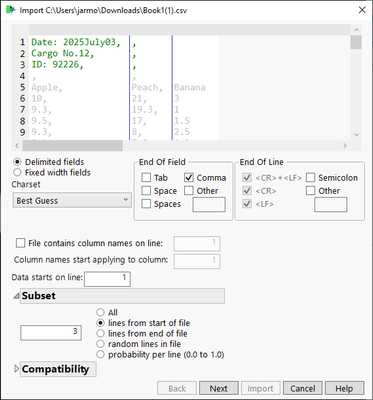

Now you have your data. Do second open with preview but now just pick your metadata
Then you can move the data over to your original data in many different ways.

Read the CSV interactively with JMP to allow easier reading from specific rows. You can do it multiple times to first get the metadata and in second open get data. Or you can load it is a text file and parse it into JMP table.
