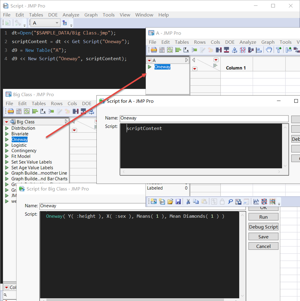

How to copy the script of one table to another table using JSL?
dt=Open("$SAMPLE_DATA/Big Class.jmp");
scriptContent = dt << Get Script("Oneway");
d9 = New Table("A");
d9 << New Script("Oneway", scriptContent);
Thanks Experts!

Re: How to copy the script of one table to another table using JSL?
There are plenty of demonstrations of saving expressions to table script so here is a repeat
Names Default To Here(1);
ow_script = dt << Get Script("Oneway");
dt2 = Open("$SAMPLE_DATA/Big Class Families.jmp");
Eval(EvalExpr(
	dt2 << New Script("Oneway", Expr(NameExpr(ow_script)));
-Jarmo
