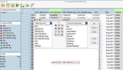

I have the data as follows and whatever I tried I can't make the new formula column a numeric one.
Could someone help please?

To get a slightly simpler formula, use multiple arguments in Substitute().
For example:
Substitute(:Comment, "!", " ", "+", " ", "%", " ", "_", " ", "-", " ", "?", " ");

Thank you MS,
Thank you jvillaumie,
Both work very well !
I am continuously checking the tutorials, books, help, webcasts but sometimes when it comes to action some very simple thing is missing. In this example I knew the Substitute function but did not know it could be surrounded by another Substitute and another and another and by collapse whitespace and lowercase functions...
Many many thanks again, it saved me 8 minutes for each day of my rest life...

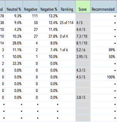

Dear all,
again to same topic this time I can not create a formula column which divides the first number by second number (4/5, 44./5, 7.3/10...etc...)
Substraction does not work cos no equal lenght, Substitute is not a way to go Words can not seperate the characters....
many thanks!

I have not read the whole thread. But perhaps this is close (if you can depend on the 'divide' delimiter):
New Table( "Convert Char Fraction",
Add Rows( 4 ),
New Column( "Char Fraction",
Character,
"Nominal",
Set Values( {"4 / 5", "3/2", "27/     26", "122       /37.6"} )
New Column( "Result",
Numeric,
"Continuous",
Format( "Fixed Dec", 12, 3 ),
Formula(
Num( Trim( Word( 1, :Char Fraction, "/" ) ) ) /
Num( Trim( Word( 2, :Char Fraction, "/" ) ) )

You should be able to use the following formula:
Num(Word(1,:Score, "/"))/Num(Word(1,:Score, "/"))
Dave
saitcopuroglu
Level IV
Re: How to convert char to num
Many thanks, both work.
