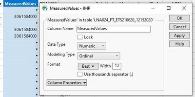

I am trying to convert a column Data type from Character to Numeric, however i am losing the all the Numeric values from the column while converting the data type to Numeric.
Please find the attached screenshots for the same.
How to retain the numeric values from a column when i change it's data type from Character into Numeric??

Picture01 - OriginalColumnFormat  - Screenshot of Column's original data type
Picture02 - ColumnafterChangingDatatype- Screenshot of Column's after changing the data type to Numeric.

I did try your suggestion by removing non-numeric values using Recode option from the column and tried to convert the columns data type from character to Numeric. However still all the values are disappearing as before when the data type is changed to Numeric.
In recoding option, JMP was able to differentiate Numeric values and string characters.
