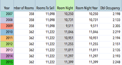

I have a data set and I would like to compare the increase/decrease in percentages for each column by year
Let's say I would like to know the percentage of RoomNight change compared to the year before.
Could any one please tell me the formula for it?

You can use the Lag() function. For example:
New Column("Annual Change",
    Numeric,
    Format("Percent", 12, 1),
    Formula(If(Row() != 1, ((:Room Night - Lag(:Room Night, 1)) / Lag(:Room Night, 1))))

Thank you again and what is the logic of Lag() when comparing all years to the first year or second (or any selected year)?
Lets say I would like to compare the Room Night inc/dec to the 2007 or 2013?
Many many thanks for your support.

Lag() always refer to a row relative to the current row. To compare with a fixed reference year it may be easier to use an index. Lag() can also be used but would require that the data is regular with no missing years.
// Using a fixed index, assuming 2007 in first row
New Column("Change since 2007",
    Numeric,
    Formula((:Room Night - :Room Night[1]) / :Room Night[1])
// The same using lag (assuming there are no missing years)
New Column("Change since 2007_2",
    Numeric,
    Formula((:Room Night - Lag(:Room Night, :Year[Row()] - 2007)) / Lag(:Room Night, :Year[Row()] - 2007))
