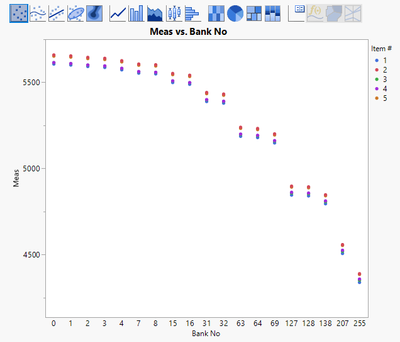

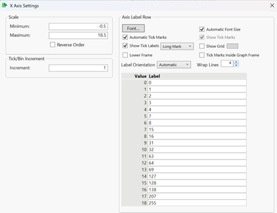

2. For the X-Axis however, I want to plot it in such a way that the values match the label. Currently, in the X Axis Settings, I see that Values are assigned sequentially, but my labels (which represent the data from my Bank No column) are chosen at certain intervals.

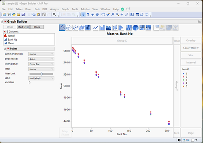

3. This is the plot produced by the above settings
4. The plot I wanted would have an X-Axis of Bank No in sequential order from 0 to 255 (without skipping any number), such that I would only be seeing "Meas" values on the X-Axis value that has data... and blank otherwise.
5. The reason behind this is these points would actually look linear of values from Bank No 0 is connected to Bank No 255 by line. On the above plot, I couldn't convey the message that it should be linear in appearance.

Your Bank No. is set to ordinal.  Set it to Continuous and I believe you will get what you want
Jim

Wow it's that easy. It's embarassing. Thanks.
