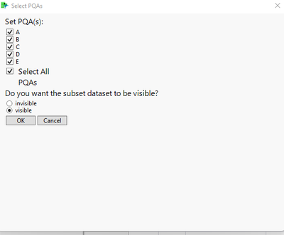

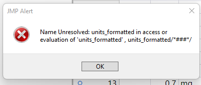

I am not sure what is wrong with my script. It is supposed to take the user input values of PQA (a categorical variable) and produce output scripts that contain customized One-way results for each PQA, using a subset data set to get the information needed to read into the scripts that are saved to the original data table. For example, when I run the following JMP code on the toy Data table with the script's user input window, I get an error message (see figures below).

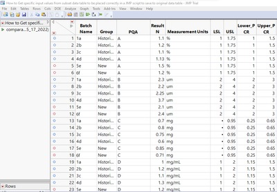

Toy JMP dataset:
JMP User Input modal window
JMP error message: "Name Unresolved: units_formatted in access or evaluation of 'units_fortmatted',..."
Why is JMP not reading, for example, the Measurement units column from each PQA subset dataset listDT produced by each iteration of the for loop so that the measurement units for PQA = A is "%" and placed on the y-axis label of the chart as in the script?

If you could attach a sample data table, it would be very helpful/
Jim
kachveder
Level III
Re: How to Get specific input values from subset data table to be placed correctly in a JMP script to save to original data table?
Sorry and thanks for letting me know! I forget to out it up in my original posting as an attachment.
