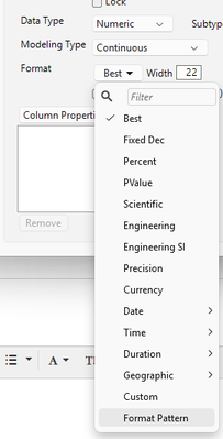

Option 1: converting the Data Type of the second column  to numeric and AT THE SAME TIME adjust the  display/ and Input Format Pattern:
