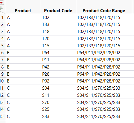

Hello,
I have a list of product (> 100) with different product codes of each product. I would like to create new column "Product Code Range" that it concatenates the product code for each product as shown below example. How to write JSL code that can do this task?

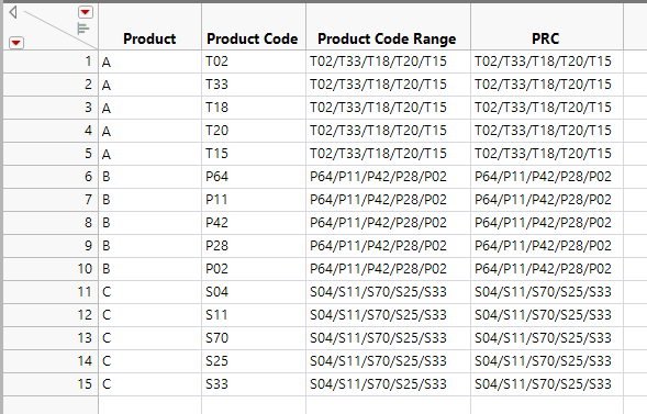

One more option came to my mind which won't require any scripting (but can be easily scripted/JMP can mostly script it) (note that order will most likely change with this method).
1. Split the original data
2. Select all the columns which start by P and use Cols/Combine Columns to create new column
3. Join new table with the new combined column to the original data
4. Result:

And here is yet another way to do this, using Get Rows Where()
New Column( "PRC",
	character,
	set each value(
		theProduct = :Product[Row()];
		Concat Items(
			:Product Code[Current Data Table() << get rows where( :Product == theProduct )],
Jim
