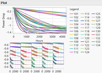

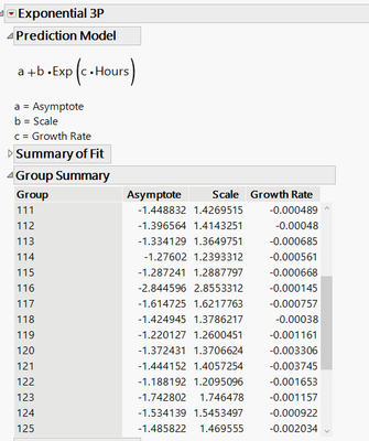

- the Group option in Fit Curve is great, there is a nice overview of the fit parameters:
and all fits can be compared within the same plot:
