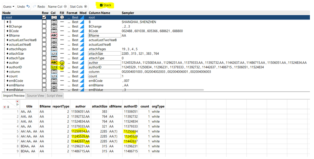

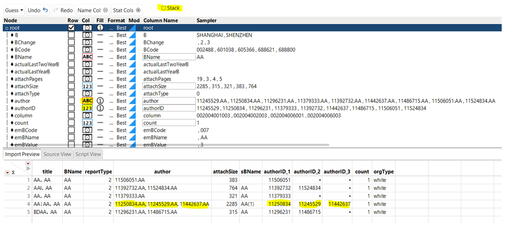

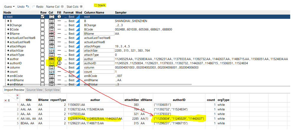

The original data rows contain fields that are arrays (author and authorID.) The stack option determines if those arrays make more rows.
unstacked keeps the multiple authors on one row:
vs stacked, which produces the 9 rows (the sampler won't always show all the values, but this time they all fit):
Unstacked can collapse the authorID like this (using expression to hold the authorID Col):
You can change the author field too, if it helps, but the comma separated list in the character field might be easier to use than an expression for the numeric field. Or you might prefer the authorID_N column names.
Above, I removed a bunch of columns (to focus on the author columns.) You can select multiple columns in the table view at the bottom and then click any selected Col in the top and change them all to "no column" to remove unwanted columns.

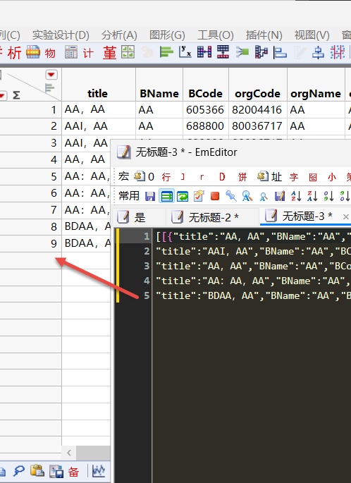

Actually, I just want to know how this JSON can be turned into a perfect table
tx="\[[{"title":"AA,AA","BName":"AA","BCode":"605366","orgCode":"82004416","orgName":"AA","orgSName":"AA","publishDate":"2025-12-28 00:00:00.","infoCode":"AP202512281809952250","column":"002004006001","predictNextTwoYearB":"","predictNextTwoYearPe":"","predictNextYearB":"","predictNextYearPe":"","predictThisYearB":"","predictThisYearPe":"","predictLastYearB":"","predictLastYearPe":"","actualLastTwoYearB":"","actualLastYearB":"","industryCode":"","industryName":"","emIndustryCode":"","indvInduCode":"538","indvInduName":"AA","emBCode":"","emBValue":"","emBName":"","lastEmBCode":"","lastEmBValue":"","lastEmBName":"","BChange":"","reportType":2,"author":["11506051.AA"],"indvIsNew":"001","researcher":"AA","newListingDate":"2020-08-12 00:00:00.","newPurchaseDate":"2020-07-31 00:00:00.0","newIssueB":9.98,"newPeIssueA":22.78,"indvAimBT":"","indvAimBL":"","attachType":"0","attachSize":383,"attachPages":3,"encodeUrl":"6XT6d6nxZNcP9JXS1dtw9ivwowNnxWgBjsEKvrMIHoo=","sBName":"","sBCode":"","B":"SHANGHAI","authorID":["11506051"],"count":1,"orgType":"white"},{"title":"AAI,AA","BName":"AA","BCode":"688800","orgCode":"80036717","orgName":"AA","orgSName":"AA","publishDate":"2025-12-28 00:00:00.","infoCode":"AP202512281809913359","column":"002004001003","predictNextTwoYearB":"2.67","predictNextTwoYearPe":"32.97","predictNextYearB":"2.08","predictNextYearPe":"42.24","predictThisYearB":"1.46","predictThisYearPe":"60.44","predictLastYearB":"","predictLastYearPe":"","actualLastTwoYearB":"","actualLastYearB":"","industryCode":"","industryName":"","emIndustryCode":"","indvInduCode":"459","indvInduName":"AA","emBCode":"007","emBValue":"3","emBName":"AA","lastEmBCode":"007","lastEmBValue":"3","lastEmBName":"AA","BChange":3,"reportType":2,"author":["11392732.AA","11524834.AA"],"indvIsNew":"001","researcher":"AA,AA","newListingDate":"2021-07-22 00:00:00.","newPurchaseDate":"2021-07-12 00:00:00.0","newIssueB":15.02,"newPeIssueA":24.49,"indvAimBT":"","indvAimBL":"","attachType":"0","attachSize":764,"attachPages":5,"encodeUrl":"6XT6d6nxZNcP9JXS1dtw9snalC40a3QwRrj9tML8YAw=","sBName":"AA","sBCode":"0301","B":"SHANGHAI","authorID":["11392732","11524834"],"count":1,"orgType":"white"},{"title":"AA,AA","BName":"AA","BCode":"601038","orgCode":"80064","orgName":"AA","orgSName":"AA","publishDate":"2025-12-28 00:00:00.","infoCode":"AP202512281809893801","column":"002004002003","predictNextTwoYearB":"0.9","predictNextTwoYearPe":"15.7600","predictNextYearB":"0.8100","predictNextYearPe":"17.4900","predictThisYearB":"0.7900","predictThisYearPe":"17.9200","predictLastYearB":"","predictLastYearPe":"","actualLastTwoYearB":"","actualLastYearB":"","industryCode":"","industryName":"","emIndustryCode":"","indvInduCode":"910","indvInduName":"AA","emBCode":"007","emBValue":"3","emBName":"AA","lastEmBCode":"007","lastEmBValue":"3","lastEmBName":"AA","BChange":3,"reportType":2,"author":["11379333.AA"],"indvIsNew":"001","researcher":"AA","newListingDate":"2012-08-08 00:00:00.","newPurchaseDate":"2012-07-27 00:00:00.0","newIssueB":5.4,"newPeIssueA":14.44,"indvAimBT":"","indvAimBL":"","attachType":"0","attachSize":321,"attachPages":4,"encodeUrl":"6XT6d6nxZNcP9JXS1dtw9vuL66I7rHatL9vNIud7cP0=","sBName":"AA","sBCode":"0101","B":"SHANGHAI","authorID":["11379333"],"count":1,"orgType":"white"},{"title":"AA:AA,AA","BName":"AA","BCode":"002488","orgCode":"80162","orgName":"AA","orgSName":"AA","publishDate":"2025-12-25 00:00:00.","infoCode":"AP202512251807934364","column":"002004001003","predictNextTwoYearB":"1.0100","predictNextTwoYearPe":"8.4","predictNextYearB":"0.3300","predictNextYearPe":"25.4","predictThisYearB":"0.0600","predictThisYearPe":"131.8","predictLastYearB":"","predictLastYearPe":"","actualLastTwoYearB":"","actualLastYearB":"","industryCode":"","industryName":"","emIndustryCode":"","indvInduCode":"481","indvInduName":"AA","emBCode":"007","emBValue":"3","emBName":"AA","lastEmBCode":"","lastEmBValue":"","lastEmBName":"","BChange":2,"reportType":2,"author":["11250834.AA","11245529.AA","11442637.AA"],"indvIsNew":"001","researcher":"AA,AA,AA","newListingDate":"2010-10-21 00:00:00.","newPurchaseDate":"2010-10-11 00:00:00.0","newIssueB":22,"newPeIssueA":73.33,"indvAimBT":"","indvAimBL":"","attachType":"0","attachSize":2285,"attachPages":19,"encodeUrl":"MKF7cC+MZ9vDOQWsqD7ZgmRE9eUeYHJK9njuGLTcICI=","sBName":"AA(1)","sBCode":"0201","B":"SHENZHEN","authorID":["11250834","11245529","11442637"],"count":1,"orgType":"white"},{"title":"BDAA,AA","BName":"AA","BCode":"688621","orgCode":"80064","orgName":"AA","orgSName":"AA","publishDate":"2025-12-25 00:00:00.","infoCode":"AP202512251807725254","column":"002004006003","predictNextTwoYearB":"2.4600","predictNextTwoYearPe":"28.0","predictNextYearB":"2.2600","predictNextYearPe":"30.5400","predictThisYearB":"1.8","predictThisYearPe":"38.3300","predictLastYearB":"","predictLastYearPe":"","actualLastTwoYearB":"","actualLastYearB":"","industryCode":"","industryName":"","emIndustryCode":"","indvInduCode":"727","indvInduName":"AA","emBCode":"007","emBValue":"3","emBName":"AA","lastEmBCode":"007","lastEmBValue":"3","lastEmBName":"AA","BChange":3,"reportType":2,"author":["11296231.AA","11486715.AA"],"indvIsNew":"001","researcher":"AA,AA","newListingDate":"2021-06-21 00:00:00.","newPurchaseDate":"2021-06-09 00:00:00.0","newIssueB":26.89,"newPeIssueA":29.72,"indvAimBT":"","indvAimBL":"","attachType":"0","attachSize":315,"attachPages":4,"encodeUrl":"MKF7cC+MZ9vDOQWsqD7ZgvFJHAi4XRobbkVOxAB2GK4=","sBName":"AA","sBCode":"0101","B":"SHANGHAI","authorID":["11296231","11486715"],"count":1,"orgType":"white"}]]\";
 d1 =jsontodatatable(tx);
This will increase the number of lines
lala
Level IX
Re: How is this regular expression replacement implemented
Four rows have been added
That's why I came up with this stupid idea

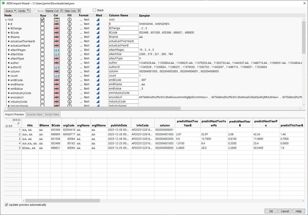

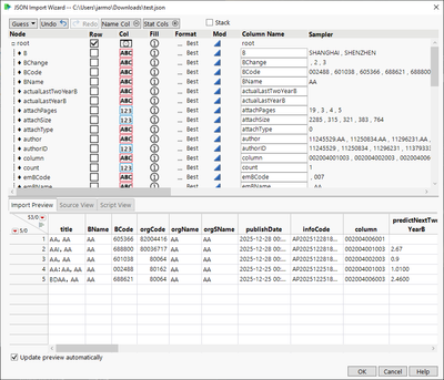

JMP does offer JSON Import Wizard.
Is there a specific reason to avoid using that first? When you figure out which options to use that you can try to transform them to JSON To Data Table as it does offer you with some parameters such as Guess() or JSON Settings()
-Jarmo
lala
Level IX
It can only be operated manually once
Thanks Experts!
jthi
You do it once manually to let JMP assist you in scripting like you always should do with graphs, platforms and table transforms.
Create a .json file from your string
Use JMP's Open and locate the file and open it as Using Preview
Try different options in the wizard. This is the result after just using Wide guess

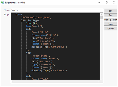

Export it to JMP if it looks fine. Check Source table script

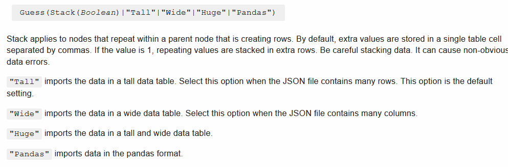

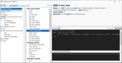

This could be OK for you if the structure is already the same. If not, go to scripting index/jmp help and check if Open has any better options to use. Quickly looking it doesn't, look for JSON from Scripting Index. Come across JSON To Data Table which seems to have mention of Guess and "Wide"
Click Topic Help to get useful information about the argumentsJSON To Data Table(JSON string, (<Private(Boolean)>|<Invisible(Boolean)>), <Guess(Stack(Boolean)|"Ta...
Remember that you used "Wide" Guess in the JSON Wizard.

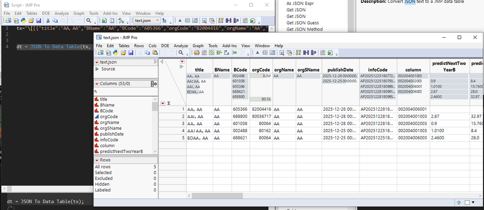

Modify your script to use Guess with JSON To Data Table
View more...
Names Default To Here(1);
json = "\[[{"title":"AA,AA","BName":"AA","BCode":"605366","orgCode":"82004416","orgName":"AA","orgSName":"AA","publishDate":"2025-12-28 00:00:00.","infoCode":"AP202512281809952250","column":"002004006001","predictNextTwoYearB":"","predictNextTwoYearPe":"","predictNextYearB":"","predictNextYearPe":"","predictThisYearB":"","predictThisYearPe":"","predictLastYearB":"","predictLastYearPe":"","actualLastTwoYearB":"","actualLastYearB":"","industryCode":"","industryName":"","emIndustryCode":"","indvInduCode":"538","indvInduName":"AA","emBCode":"","emBValue":"","emBName":"","lastEmBCode":"","lastEmBValue":"","lastEmBName":"","BChange":"","reportType":2,"author":["11506051.AA"],"indvIsNew":"001","researcher":"AA","newListingDate":"2020-08-12 00:00:00.","newPurchaseDate":"2020-07-31 00:00:00.0","newIssueB":9.98,"newPeIssueA":22.78,"indvAimBT":"","indvAimBL":"","attachType":"0","attachSize":383,"attachPages":3,"encodeUrl":"6XT6d6nxZNcP9JXS1dtw9ivwowNnxWgBjsEKvrMIHoo=","sBName":"","sBCode":"","B":"SHANGHAI","authorID":["11506051"],"count":1,"orgType":"white"},{"title":"AAI,AA","BName":"AA","BCode":"688800","orgCode":"80036717","orgName":"AA","orgSName":"AA","publishDate":"2025-12-28 00:00:00.","infoCode":"AP202512281809913359","column":"002004001003","predictNextTwoYearB":"2.67","predictNextTwoYearPe":"32.97","predictNextYearB":"2.08","predictNextYearPe":"42.24","predictThisYearB":"1.46","predictThisYearPe":"60.44","predictLastYearB":"","predictLastYearPe":"","actualLastTwoYearB":"","actualLastYearB":"","industryCode":"","industryName":"","emIndustryCode":"","indvInduCode":"459","indvInduName":"AA","emBCode":"007","emBValue":"3","emBName":"AA","lastEmBCode":"007","lastEmBValue":"3","lastEmBName":"AA","BChange":3,"reportType":2,"author":["11392732.AA","11524834.AA"],"indvIsNew":"001","researcher":"AA,AA","newListingDate":"2021-07-22 00:00:00.","newPurchaseDate":"2021-07-12 00:00:00.0","newIssueB":15.02,"newPeIssueA":24.49,"indvAimBT":"","indvAimBL":"","attachType":"0","attachSize":764,"attachPages":5,"encodeUrl":"6XT6d6nxZNcP9JXS1dtw9snalC40a3QwRrj9tML8YAw=","sBName":"AA","sBCode":"0301","B":"SHANGHAI","authorID":["11392732","11524834"],"count":1,"orgType":"white"},{"title":"AA,AA","BName":"AA","BCode":"601038","orgCode":"80064","orgName":"AA","orgSName":"AA","publishDate":"2025-12-28 00:00:00.","infoCode":"AP202512281809893801","column":"002004002003","predictNextTwoYearB":"0.9","predictNextTwoYearPe":"15.7600","predictNextYearB":"0.8100","predictNextYearPe":"17.4900","predictThisYearB":"0.7900","predictThisYearPe":"17.9200","predictLastYearB":"","predictLastYearPe":"","actualLastTwoYearB":"","actualLastYearB":"","industryCode":"","industryName":"","emIndustryCode":"","indvInduCode":"910","indvInduName":"AA","emBCode":"007","emBValue":"3","emBName":"AA","lastEmBCode":"007","lastEmBValue":"3","lastEmBName":"AA","BChange":3,"reportType":2,"author":["11379333.AA"],"indvIsNew":"001","researcher":"AA","newListingDate":"2012-08-08 00:00:00.","newPurchaseDate":"2012-07-27 00:00:00.0","newIssueB":5.4,"newPeIssueA":14.44,"indvAimBT":"","indvAimBL":"","attachType":"0","attachSize":321,"attachPages":4,"encodeUrl":"6XT6d6nxZNcP9JXS1dtw9vuL66I7rHatL9vNIud7cP0=","sBName":"AA","sBCode":"0101","B":"SHANGHAI","authorID":["11379333"],"count":1,"orgType":"white"},{"title":"AA:AA,AA","BName":"AA","BCode":"002488","orgCode":"80162","orgName":"AA","orgSName":"AA","publishDate":"2025-12-25 00:00:00.","infoCode":"AP202512251807934364","column":"002004001003","predictNextTwoYearB":"1.0100","predictNextTwoYearPe":"8.4","predictNextYearB":"0.3300","predictNextYearPe":"25.4","predictThisYearB":"0.0600","predictThisYearPe":"131.8","predictLastYearB":"","predictLastYearPe":"","actualLastTwoYearB":"","actualLastYearB":"","industryCode":"","industryName":"","emIndustryCode":"","indvInduCode":"481","indvInduName":"AA","emBCode":"007","emBValue":"3","emBName":"AA","lastEmBCode":"","lastEmBValue":"","lastEmBName":"","BChange":2,"reportType":2,"author":["11250834.AA","11245529.AA","11442637.AA"],"indvIsNew":"001","researcher":"AA,AA,AA","newListingDate":"2010-10-21 00:00:00.","newPurchaseDate":"2010-10-11 00:00:00.0","newIssueB":22,"newPeIssueA":73.33,"indvAimBT":"","indvAimBL":"","attachType":"0","attachSize":2285,"attachPages":19,"encodeUrl":"MKF7cC+MZ9vDOQWsqD7ZgmRE9eUeYHJK9njuGLTcICI=","sBName":"AA(1)","sBCode":"0201","B":"SHENZHEN","authorID":["11250834","11245529","11442637"],"count":1,"orgType":"white"},{"title":"BDAA,AA","BName":"AA","BCode":"688621","orgCode":"80064","orgName":"AA","orgSName":"AA","publishDate":"2025-12-25 00:00:00.","infoCode":"AP202512251807725254","column":"002004006003","predictNextTwoYearB":"2.4600","predictNextTwoYearPe":"28.0","predictNextYearB":"2.2600","predictNextYearPe":"30.5400","predictThisYearB":"1.8","predictThisYearPe":"38.3300","predictLastYearB":"","predictLastYearPe":"","actualLastTwoYearB":"","actualLastYearB":"","industryCode":"","industryName":"","emIndustryCode":"","indvInduCode":"727","indvInduName":"AA","emBCode":"007","emBValue":"3","emBName":"AA","lastEmBCode":"007","lastEmBValue":"3","lastEmBName":"AA","BChange":3,"reportType":2,"author":["11296231.AA","11486715.AA"],"indvIsNew":"001","researcher":"AA,AA","newListingDate":"2021-06-21 00:00:00.","newPurchaseDate":"2021-06-09 00:00:00.0","newIssueB":26.89,"newPeIssueA":29.72,"indvAimBT":"","indvAimBL":"","attachType":"0","attachSize":315,"attachPages":4,"encodeUrl":"MKF7cC+MZ9vDOQWsqD7ZgvFJHAi4XRobbkVOxAB2GK4=","sBName":"AA","sBCode":"0101","B":"SHANGHAI","authorID":["11296231","11486715"],"count":1,"orgType":"white"}]]\";
dt_json = JSON To Data Table(json, Guess(Stack(0), "Wide"));
-Jarmo
