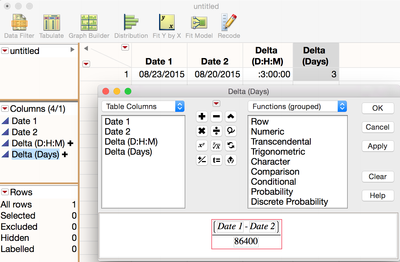

To get the difference in days between two dates in JMP (in D/M/Y format), you can easily do the following:
Easiest Way: Delta (Days)
Step 1: Create a new column in your data table
Step 2: Subtract the first date from the second date and divide this by 86,400
JMP returns the date difference in seconds, so 86,400 is the total seconds in a day to get this convereted into a count of days.
See below for the formula.
9640_Screen Shot 2015-08-23 at 7.15.46 AM.png9640_Screen Shot 2015-08-23 at 7.15.46 AM.png
AlternativeWay: Delta (D:H:M) Time Duration
Step 1: Create a formula in a new column in your data table
Step 2: Just subtract the first date from the second date
Step 3: In the column properties, under format, select Duration day:hr:m from the drop down list
This will return the difference in day count, plus any remaining hours and minutes.
See below for the formula and format:
9642_Screen Shot 2015-08-23 at 7.25.47 AM.png9642_Screen Shot 2015-08-23 at 7.25.47 AM.png
Hope this helps!
Scott

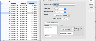

Goutam,
My pedestrian attempt gave a solution. Use column formula and subtract column 2 from columns 1 and then format columns 3 to display in days.

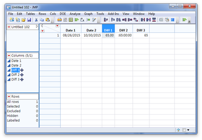

I would not go as far as saying that your statement is blasphemy, but in my experience, JMP is orders of magnitude better at handling date-times than Excel. Due to the nature of our work, we deal with timing data extensively. The very fact that JMP, unlike Excel, has a duration time format has been a godsend for us. I have lost count of the number of times that we have had to redo calculations in the past using Excel because of date-time format issues, but those problems disappeared once my analytical team began using JMP for analytics and became knowledgeable of how JMP handles date-times.
I have battled with date-time data in Excel for over a decade and often have to resort to VBA scripting to overcome Excel's shortcomings. Even then there was always the risk of someone getting a format issue. In JMP I have never needed to script date-time computations as most things can be handled by either using a simple formula and setting the format of a column or otherwise resolved with the extensive set of date-time functions JMP provides for column formulas. The screenshot below shows what the original poster wanted using three different methods already mentioned in this thread and required no scripting whatsoever.
The first difference uses a simple formula, (Date 2 - Date 1) / 86400, to compute the difference in days. Given that JMP stores date-times as a seconds count from 1 JAN 1904 12:00:00 AM, getting the number of days is just that simple. This method is useful for someone that wants any portion of days reported in decimal form.
The second difference is even simpler as it does not require knowing the number of seconds in a day. The formula used is just Date 2 - Date 1, and the column is formatted as a duration (:day:hr:m). Using this method reports the number of days in time format show remaining time is shown as hours, minutes, and seconds.
The last method uses the Date Difference function and returns just the number of days. Admittedly, Excel does this by default if you subtract Date 1 from Date 2, but what JMP sacrifices by not just spitting out the number of days from Date 2 - Date 1 more than makes up for Excel's foibles with date-time computations.
