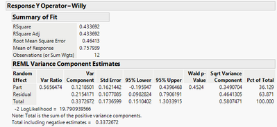

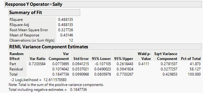

As an example I use the '2 Factors Nested' sample data set. Treating Operators Sally and Willy as they were two different labs I wanted to compare, and treating Part as random, I get the following Fit Model output for each Operator:
Sally measures with a total variation standard deviation of 0.43, and Willy measures with a total standard deviation of 0.58. I would like to test, if these are statistically different?

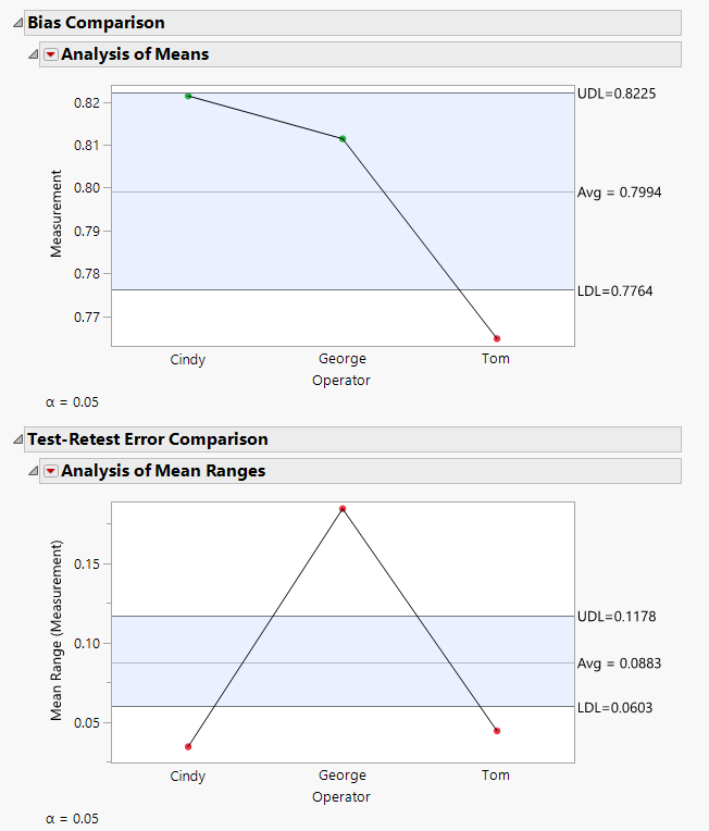

I might be oversimplifying this, but would you get what you need by treating this as a measurement system analysis? Specifically, the Bias Comparison and Test-Retest Error options in the EMP personality tests if nuisance factors are measured differently. The picture below is from the 2 Factors Crossed data set, since you mentioned that each lab (Operator) is measuring the same part multiple times.

just a quick add-on.  the MSA is a variance only model... a mixed model except without the fixed effect.
