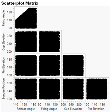

As I advanced through the BO iterations, I noticed that a certain combination of factors resulted in the ball being dropped and not projected. I needed to set up a constraint:
Constraint:  (Release Angle – Firing Angle) should never be less than 30
Something like this:
I exported the Candidate set and set up the constraints by removing the "forbidden" combinations. However after modifying and uploading the Candidate set Set, BO continued with the original Candidate set after the next iteration. It did not use the uploaded, constrained Candidate set.
What is the correct way to modify and "freeze" the constrained Candidate set?

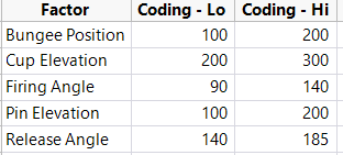

P.S. Should anybody want to run this same exercise, here are the Coding properties:
The Target is to project a ball 545 mm +/- 20mm

@jpol and @statman I've really enjoyed your dialogue here, those quotes are beautiful and thanks to your collaborative spirit and interest in discussion, we all get to benefit. It's no wonder I've always felt (intuited) that applied statistical learning is deeper and more concrete for me in the context of experimentation (formally designed or otherwise) on actual real-life experiments (that I've run myself or have been involved closely with in the planning and execution).
And Thanks @Victor_G for aptly pointing out how a constraint can be generated/ enforced and saved to the data table script automatically within Bayes Opt using the Augmented Prediction Profiler, specifically under the Linear Constraints Outline, available under the Optimization outline (Augmented Prediction Profiler red triangle menu > Optimization and Desirability> Optimization Control Panel) and within the Factors Tab (clicking on "Add Linear Constraint" Button).
