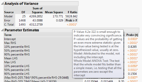

So I noticed that others had the ability to hover over things and a text box would appear with info about the object.
The ‘hover text’ pop-up that you get when you hold the mouse over a field.
However I seem to be missing it, when I hover over stuff nothing pops up, is there way to enable it?
I'm using JMP 13.
Here's an example of the hover text:
ezQszSM

so I checked and that was already checked. I tried hovering over a similar analysis like in that example picture, but no text pops up still.
Nevermind! I realized you have to move the mouse in a circular motion in order for the text to show up.
Thanks!

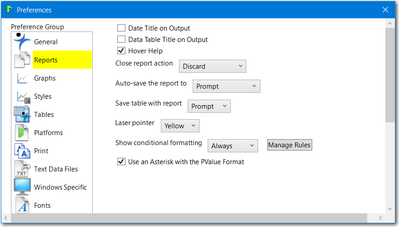

Check your preferences. Main Menu > File > Preferences or CTRL + K, Click on Reports. Make sure Hover Help is checked.

Jeff_Perkinson
Re: How do I enable hover help text?
The hover help is triggered by making a small circle over an item in the report.
-Jeff

Below are a couple of things to do to trouble shoot the problem. If they don't work, you should contact JMP Technical Support or you local IT person.
  1. For p-values, etc, you need to circle your mouse near the reported item. It can be touchy
  2. Preferences, Report  and General, press the Reset to Defaults  [just in case task]
