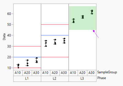

Hi Jarmo,
When there are multiple sets of X-Axis phase/groups, this line may obscure the boxplot data points. I would like to use the following image instead.

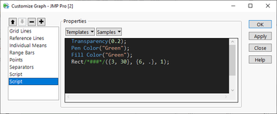

Then you could use Rect instead of Line(), no need for graph box (graph box basically is already there). You will have to manage missing values someway if you go with this option as missing points will cause issues with Rect()
Eval(EvalExpr(
	fb << Add Graphics Script(
		Transparency(0.2);
		Pen Color("Green");
		Fill Color("Green");
		Rect(Expr(lslstart), Expr(uslend), 1);
-Jarmo

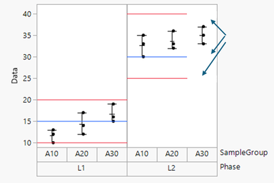

Hi Jarmo,
Thanks for your prompt reply.
One more question for adding additional X-Axis value.
When I input other X value(SampleA), I modified script below. But the result of limit line is incorrect, how can I modify it?
var = dt << Variability Chart(Y(:Data), X(:Phase, :SampleGroup, :SampleA));

Sandra233
Level III
Re: How do I define spec limits by data category in variability chart
Yes, I noticed that, so I modified script for Summarize and curcount value. But limit line cannot completely cover all the conditions under phase. Limits are still based on "phase".  (Please ignore that there is no new SampleA X-Axis)
