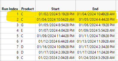

I have a indexed list of production runs of different products (A-H) and their start and end times. Sometimes there are two lines in a row with the same product (rows 1 & 2 and 7 & 8) and I would like those to be combined into one row with the start time of the first row and end time of the second row. How would I use JSL to do this?

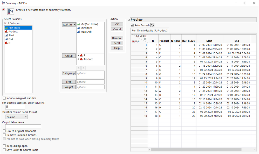

Then you can use Summary table to perform the min/max part
Remove and re-order columns from summary table as needed
Here is a script from Enhanced Log to perform those actions

// Data table summary
// → Data Table("Run Time Index By (R, Product)")
Data Table("Run Time Index") << Summary(
	Group(:R, :Product),
	Min(:Run Index),
	Min(:Start),
	Max(:End),
	Freq("None"),
	Weight("None"),
	statistics column name format("column"),
	Link to original data table(0)
