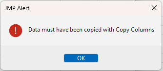

Copy/Paste columns from the header menu is my favorite one - it copies the column with the name, with the properties, and when you press CTRL+A before you copy the column: even with the data (caution: copy is fast, paste can be very slow!).
It's such a helpful function, but it wasn't there from the beginning:
Copy Script For Selected Column(s) to Clipboard
... and it got better and better over the time.
The latest improvement: JMP19 checks if the script on the clipboard is actually a column script; otherwise, it returns an error message.
