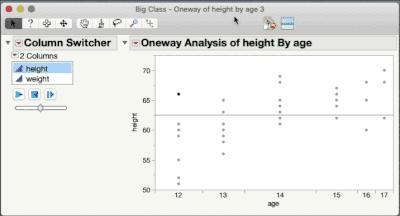

How do I automatically add all columns to the Column Switcher in .jsl
I'm very much a beginner with JSL, I'm still learning --
I have many files that I need to review with Graph Builder, and each has a different number of columns.  The only constant is that I know I want column 1 as the Overlay, column 2 in the X-axis, column 3 in the Y-axis, and all the rest of the columns in the Column Switcher.  I'd love to have a script that would open up all the Graph Builder windows for all the currently-open data tables with these settings, but I don't know how to do that.  This is the closest I've gotten:
Graph Builder(
	Size( 1900, 1200 ),
	Variables(
		X( :Column(2) ),
		Y( :Column(3) ),
		Overlay( :Column(1) )
	Elements( Points( X, Y, Legend( 10 ) ), Line( X, Y, Legend( 11 ) ) ),
	Column Switcher( :Column(3) ),
	SendToReport(
		Dispatch(
			ScaleBox
The two things I need help with:  (1) figure out how to set the Column Switcher to automatically load up all the columns in the data table without asking me, and (2) wrap this script in a loop that iterates over all the open data tables.

Impressive! I kept trying to use "Column Switcher( :Column(3), :Column(all) )" and variations of that
Would any of these improvements to the script be possible? (1) Give it instead a folder full of txt files, and have it open them one at a time in Graph Builder, and when I close Graph Builder, it closes the corresponding Data Table file and opens the next one, (2) automatically move the focus to the column switcher so I can immediately begin arrowing through the variables without needing to click in the column switcher box, (3) full size the Graph Builder window on the screen when it opens.
JMP is quickly becoming my favorite piece of software.

I can't find a way either but a few presses of the tab key will shift the focus to the list of columns in the column switcher.
-Jeff
