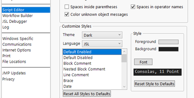

jthi
Re: How can increase the functionality of the JSL script editor?
You can do some style changes from Preferences
If you need some new capabilities, check if wish list item already has item you hope to have and if it doesn't create a new wish list item.
-Jarmo

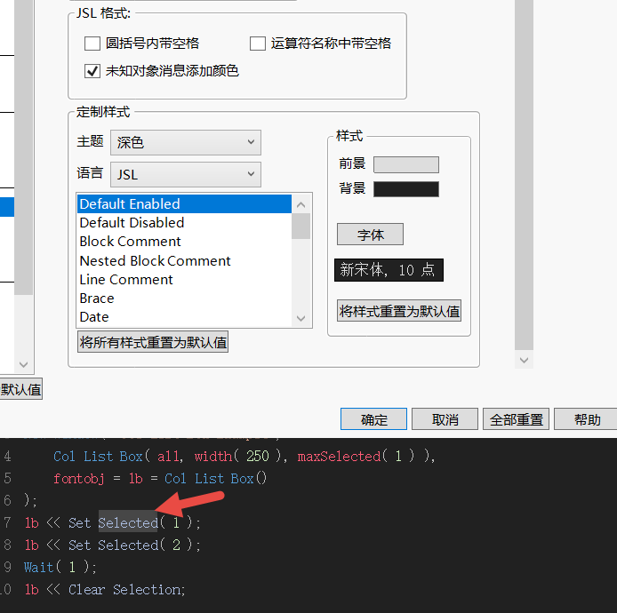

lala
Level IX
No effect. I want to set the selected text background color to white
This is how this selected change was not found.
lala
Level IX
This is the parenthesized highlight. I found the background color (white).

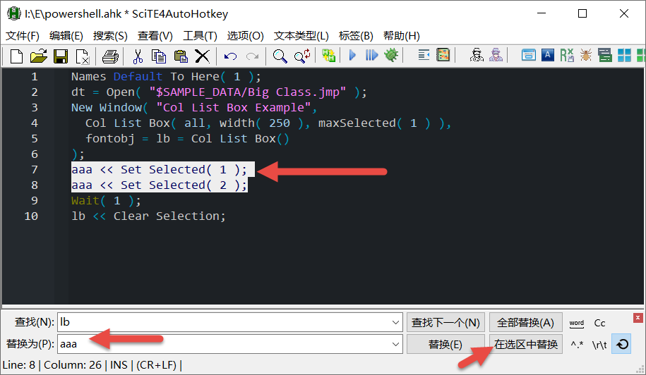

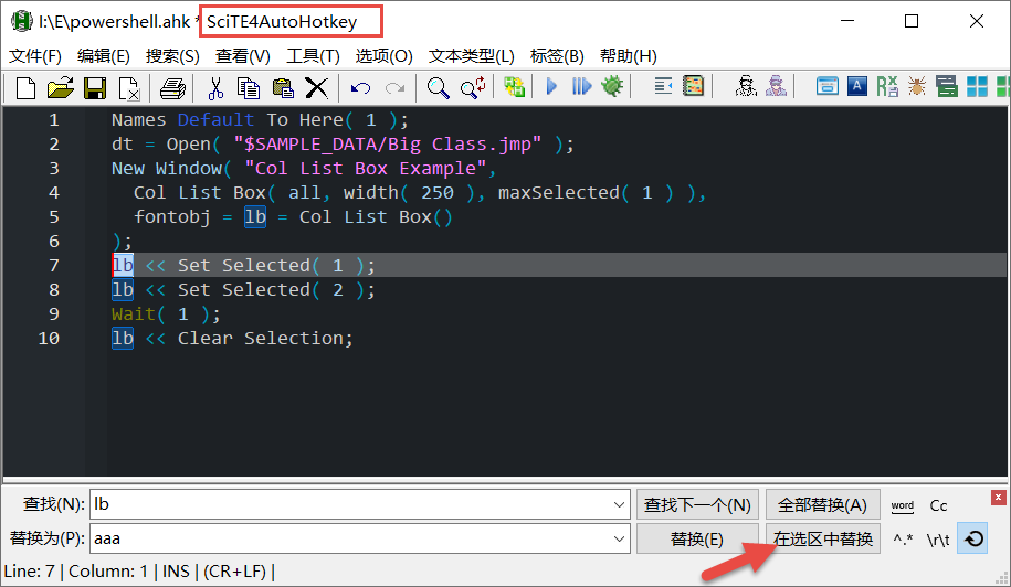

lala
Level IX
I need features like this

lala
Level IX
Replace in selected area
