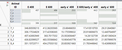

Below is some example data for 4 of my animals, the E column will be my numerator and the early e' should be the denominator. So I want to calculate a ratio where E is from HR = 600, and early e' is from 400 for each animal (the HR intervals is the same for each animal)

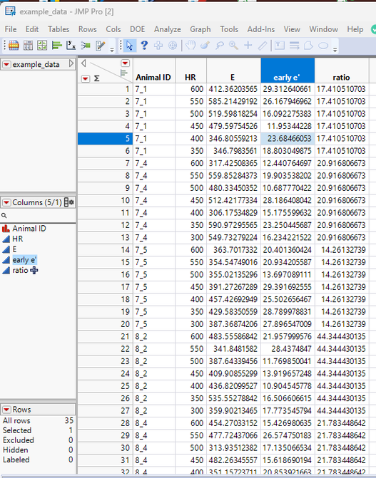

txnelson
Re: How can i choose the same observation to calculate a ratio for a series of observations?
Here is the formula I came up with
Col Mean( If( :HR == 600, :E, . ), :Animal ID ) / Col Mean(
	If( :HR == 400, :early e', . ),
	:Animal ID
Jim
