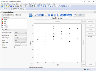

How can I see excluded item in graph builder?
I like to only exclude item from the col sum column. As that line is not hide, how can i see that on graph builder chart?

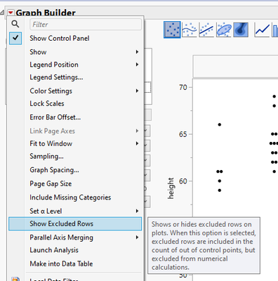

Re: How can I see excluded item in graph builder?
You hold shift + click on red triangle and enable show excluded rows
Excluded rows will then appear lightly transparent
-Jarmo
jthi
You have to hold Shift while you click on the red triangle, and it should become visible
-Jarmo

jthi
-Jarmo

jthi
-Jarmo
