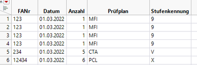

Hi, I have a datatable as shown below.
The column Anzahl shows the counts of column Prüfplan. I want JMP to make a row for every count so that Anzahl is always 1. I did that manually for row 1 as shown below, to clarify what I want to do. The original row has to be removed of course.
Can anybody help me, thank you!

Hi @Christina ,
Perhaps this tool can help - Expand by Frequency.
https://community.jmp.com/t5/JMP-Add-Ins/Expand-by-Frequency-Column-Add-In/ta-p/21361
 let us know if it works fo you.

The excellent Data Table Tools Add-in created by @brady_brady can do this. Once installed, you'll select the Add-Ins menu, then Data Table Tools, then Reshape Tables, then Unsummarize Rows

Re: How can I add (copy) rows according to number in a specific column to the datatable
That's what I wanted, thank you!
