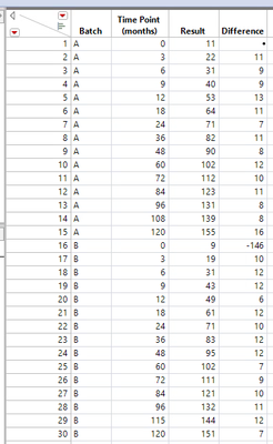

Hello,
I have the following data and I want to use the Lag function to calculate the difference between each result and the result prior to it (the data table is also attached to this message).
I am using JMP 16.
Currently I'm using the following formula in the "Difference" column:
What I can't figure out is how to get the calculation to "reset" once it gets to Batch B. I realize that even with my current formula, only the difference value in row 16 is incorrect, but still I would know to setup the formula so that it works properly within batches.
Does anyone have any suggestions?
Jeff

change your formula to
If( :"Time Point (months)"n == 0,
	:Result - Lag( :Result )
Jim

Dif() and Lag() formula functions by column group (byVar argument) - great wish by @FN
-> In JMP19, lag() and dif() can be calculated via  Col At () - which provides a grouping option.
jthi
Re: How Can I Get The Lag Function to "Reset" With Each New Batch?
You can also utilize Col Moving Average to get the previous value (Data preparation- substract column data by other column )
:Result- (Col Moving Average(:Result, 1, 1, 0, :Lot Number) * 2 - :Result)
but in your case using something like Jim suggested is most likely better. Also there is Dif function you can use instead of Lag
	Dif(:Result, 1)
