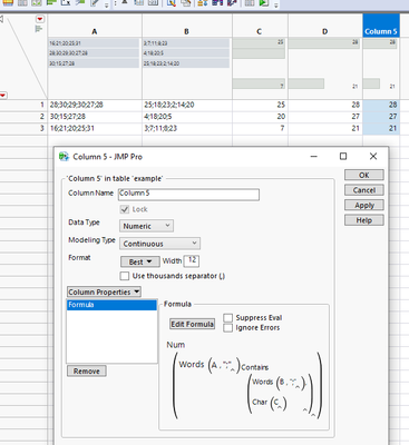

Should be fairly simple by using Words() and Contains().
Num(Words(:A, ";")[Contains(Words(:B, ";"), Char(:C))]);
See scripting index for more examples about those functions

jthi
Re: Help with searching in string
-Jarmo

txnelson
Here is one way to do it
theList = Words( :B, ";" );
location = Contains( theList, Char( :C ) );
Show( theList, location );
Try( Num( Word( location, :A, ";" ) ), . );
Jim
