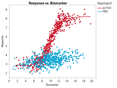

In order to better understand the issue, I created a mock data set where the Response is continuous; and the Model effects are: 1) Biomarker levels (continuous), 2) Treatment (2 categories), and 3) their interaction. The Response in the ACTIVE treatment is dependent on the Biomarker level following a logistic distribution
Here is a Graph Builder depiction of the response by biomarker levels:

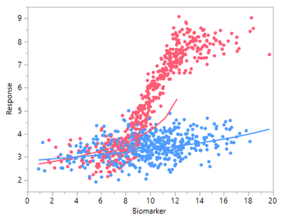

If I run the Standard Least Square model with Treatment, Biomarker, and Interaction with the Response response transformed according to a Logistic relationship (Transform > Logistic on Response), I get an odd result:
1) Predicted by Actual (note the poor fit for most of the ACTIVE group [RED])

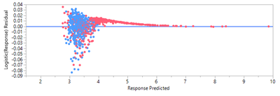

The residuals from this model are skewed as shown in the next 2 pictures:
2) Residuals plot

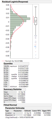

3) Residuals distribution
Clearly, I'm doing something wrong so please, help me figure out this apparently simple option.

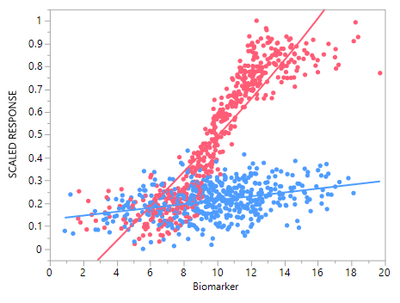

Thanks for your reply. Actually I scaled my response to be within the 0 to 1 range
((R-Min)/(Max - Min)) and the Logistic transform yields the following
Scaled response Logistic Transform.png.
If you look carefuly, the fit curves are not straight lines but still this is far from a tight fit.
Any thought?
