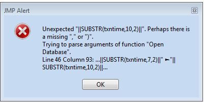

Level III
Re: Having custom date range in SQL based on user input variable
Thanks Mark but unfortunately I am seeing the following error when trying to execute
The error seems to be caused due to the concatenation of the space between the date & the time (highlighted in red). Is there any other way to have the space in between the date & the time?
TO_DATE(SUBSTR (txntime, 1,4)||"/"||SUBSTR(txntime,5,2)||"/"||SUBSTR(txntime,7,2)||" "||SUBSTR(txntime,10,2)||":"||SUBSTR(txntime,12,2)||":"||SUBSTR(txntime,14,2),'yyyy/mm/dd hh24:mi:ss') txntime
Also I have a question about the text 'am' for the where clause. Could you let me know why is it needed there?
