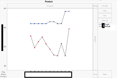

I am in graph builder and there are 2 lines, a target and the actual.  The legend indicates what each line is, but there is another layer in the data.  The triangles are one product and the circles are another product.  If I use "product" as overlay, it adds 2 additional lines but nothing about the circle and the triangle which are row states for the product.  Is there a way to add a legend that indicates what the circle and triangles are?   Note: data has been redacted for privacy reasons.

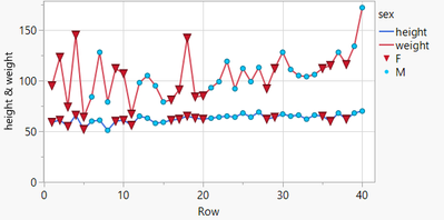

You could use the color dropzone to specify the symbols for the additional layer in the data:
New Column( "Row",
	Formula( Row() )
Graph Builder(
	Size( 501, 291 ),
	Show Control Panel( 0 ),
	Variables( X( :Row ), Y( :height ), Y( :weight, Position( 1 ) ), Color( :sex ) ),
	Elements(
		Line(
			X,
			Y( 1 ),
			Y( 2 ),
			Color( 0 ),
			Legend( 17 ),
			Summary Statistic( "Mean" )
		Points( X, Y( 2 ) ),
		Points( X, Y( 1 ) )

Note that even if legend is enabled, Graph Builder won't display legend entries for marker settings controlled by row states. Therefore, I don't recommend tho use row states to control the markers. It is much more convenient to store the information in a column and use the column as described in my previous post.
I have to admit:
the user has to set the markers manually.
much better via Column Property:
