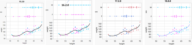

hogi
Level XIII
Re: Graph Builder: Color not working for multiple Y axes
Will be fixed in Jmp18:
generate via:
Names Default to Here(1);
mytitle=Jmp version();
:sex << Set Property(
	"Value Colors",
	{"F" = 43, "M" = 45}
dt << Graph Builder(
	Size( 390, 386 ),
	Show Control Panel( 0 ),
	Variables( X( :height ), Y( :sex ), Y( :weight ), Color( :sex ) ),
	Elements( Position( 1, 1 ), Points( X, Y, Legend( 12 ) ) ),
	Elements(
		Position( 1, 2 ),
		Points( X, Y, Legend( 13 ) ),
		Smoother( X, Y, Legend( 14 ) )
	SendToReport(
		Dispatch( {}, "graph title", TextEditBox, {Set Text( mytitle )} )
