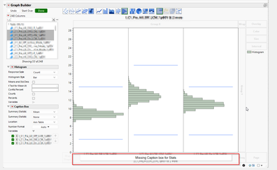

Hello,
On JMP 19, trying to add a caption box for mean/std dev on Axis Table, but it's not showing up.
Caption box issue from the previous thread
Thanks,
Jackie

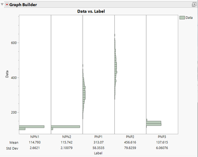

Hi @Jackie_, It's not entirely clear what the X axis looks like from the image. Can you confirm that you're graph is something like this?
Jackie_
Level VI
Re: Graph Builder Caption box not showing up Axis Table mode
@Jed_Campbell
I tried on this dataset, using parallel merged config, it doesn't show the Stats text..
Here is the code:
dt = Open( "$SAMPLE_DATA/Semiconductor Capability.jmp" );
dt << Graph Builder(
	Size( 834, 588 ),
	Show Control Panel( 0 ),
	Variables(
		X( :PNP2, Combine( "Parallel Merged" ) ),
		X( :NPN1, Position( 1 ), Combine( "Parallel Merged" ) ),
		X( :PNP1, Position( 1 ), Combine( "Parallel Merged" ) ),
		X( :PNP2, Position( 1 ), Combine( "Parallel Merged" ) ),
		X( :NPN2, Position( 1 ), Combine( "Parallel Merged" ) ),
		X( :PNP3, Position( 1 ), Combine( "Parallel Merged" ) )
	Elements(
		Histogram( X( 1 ), X( 5 ), X( 2 ), X( 3 ), X( 6 ), Legend( 6 ) ),
		Caption Box(
			X( 1 ),
			X( 2 ),
			X( 3 ),
			X( 4 ),
			X( 5 ),
			X( 6 ),
			Legend( 7 ),
			Summary Statistic( "Mean" ),
			Location( "Axis Table" )
	SendToReport(
		Dispatch( {}, "", ScaleBox,
			{Min( -262.805650205971 ), Max( 1221.55660377358 ), Inc( 200 ),
			Minor Ticks( 3 )}

I'm seeing the same behavior as you. It looks like axis tables don't like multiple variables on the X axis. As a workaround, you can stack the variables you want axis tables for, then it will work as you're intending. Script to do this is below.

dt2 = dt << Stack(
	columns( :PNP2, :NPN2, :NPN1, :PNP1, :PNP3 ),
	Drop All Other Columns( 1 ),
	Output Table( "Stack of Semiconductor Capability (PNP2 etc.)" )
dt2 << Graph Builder(
	Size( 658, 558 ),
	Variables( X( :Label ), Y( :Data ) ),
	Elements(
		Histogram( X, Y, Legend( 4 ) ),
		Caption Box(
			X,
			Y,
			Legend( 5 ),
			Summary Statistic 2( "Std Dev" ),
	SendToReport(
		Dispatch( {}, "Data", ScaleBox,
			{Min( 76.197 ), Max( 758.697 ), Inc( 200 ), Minor Ticks( 3 )}
