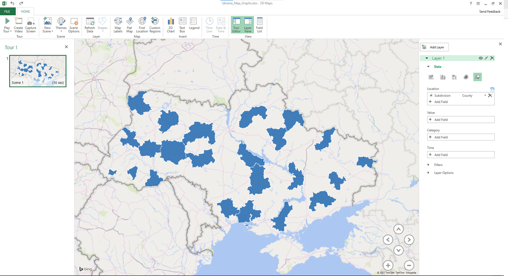

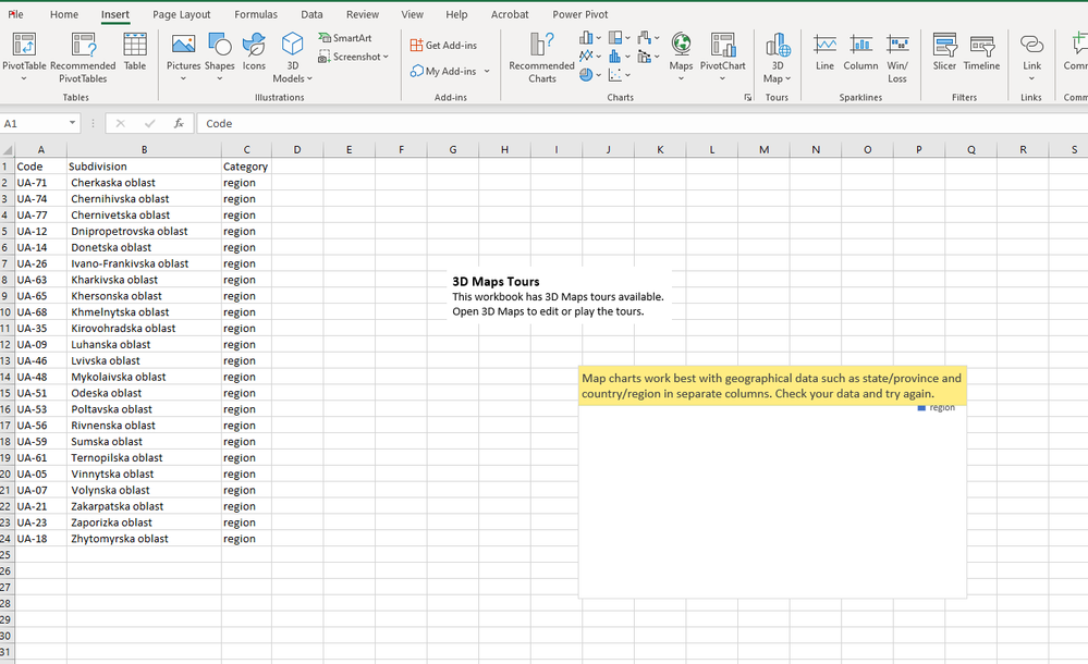

My question is whether this is integrated into JMP so I can display it in graphs. I can do this in excel now but not all areas.
Do you need me to list some examples with picture? I have files now for oblasts in Ukraine.

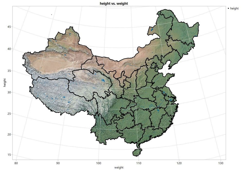

JMP 16 has a few maps built in (so do earlier versions of JMP.) I did this with a big class graph by right->click add a map and right-click->customize (to thicken+color the line and clip the simple earth bitmap to the border.)
Mainland China ProvincesMainland China Provinces

If these are not the boundaries you need, you can use SHP files to make them. I've not been through the process, but others have: https://www.google.com/search?q=jmp+shp+file shows several hits.
You might also look at the street map overlay and see if that does what you need.

This looks good but let me show you what I've done or tried in Excel and we'll start there. I didn't use lat/long though.
I work on JMP the next few days so I'll compare and post back.

I recreated some of it tonight but I have to do it better. Excel has the ability to pull the shapefiles. I don't have to load them. I give the ISO code and they plot them.
