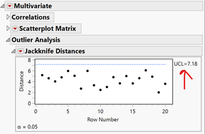

Hello,
I want to get text from a framebox, but I haven't figured out the syntax for doing this. Can someone help?
I've adapted script from this thread, but find it doesn't seem to work for what I'm looking for.
https://community.jmp.com/t5/Discussions/JSL-Retrieve-Selected-Frame-Box/m-p/14552
I also have another script that grabs numbers from the profiler graphing tool, and I've adapted that, but I think I haven't modified that properly either.
Here's an example below.

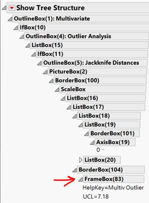

myrpt << Show tree structure;
// Try 1
mynum1 = myrpt[ Framebox(83) ] << Get text; // Send error
show( mynum1 );
// Try 2
mynum2 = Num( Report( myrpt )["Multivariate", Framebox( 83 )] << Get Text );
show( mynum2 );  // Empty
// Try 3
mynum3 = Num( Report( myrpt )["Jackknife Distances", Framebox( 83 )] << Get Text ); // Send error
show( mynum3 );
report( myrpt ) << Close report;
Is there a guide on how to get data from different parts of the tree structure?

When I show(seg), seg = DisplaySeg[]; is returned. Do you know what this is? I'm looking for the UCL value, or that entire string, because it's easy to extract what I need.
When I modify my Try 1, nynum1 ends up empty. Do you know why? It seems the framebox is found, but nothing is returned.
mynum1 = report(myrpt)[ Framebox(83) ] << Get text;
show( mynum1 );
