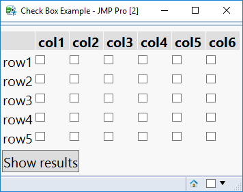

Re: Generate a Matrix of Selectable checkboxes
You can add a heading to a CheckBox within a TableBox using the <<Set Heading message. You can also add row labels by placing a StringColBox as the first column in the Table Box.
nRow = 5;
nCol = 6;
// string col box for row labels
scb = String Col Box( "", {} );
// add labels to rows
For( i = 1, i <= nRow, i++,
	scb << Add Element( "row" || Char( i ) )
// create a table box to contain everything
tbl = Table Box( scb );
// add all columns with the given number of rows
For( i = 1, i <= nCol, i++,
	Insert Into(
		tbl,
		Check Box(
			Repeat( {" "}, nRow ),
			<<Set Heading( "col" || Char( i ) )
New Window( "Check Box Example",
	tbl,
	Button Box( "Show results",
		// initialize the result
		result = {};
		// loop through each row
			// initialize the row list
			result[i] = {};
			// loop through each column getting values
			For( j = 1, j <= nCol, j++,
				result[i][j] = tbl[CheckBoxBox( j )] << get( i )
		// convert the list to a 2-d matrix
		result = Matrix( result );
		Show( result );
Window:
Justin
