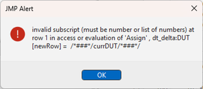

I keep getting the same error after an incomplete delta table is generated shown next
the error I get

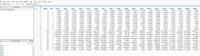

My data table

txnelson
Re: Generate Delta table to calculate deltas between two temp measurments
newRow = dt_delta << Add Rows(1);
Does not return the row number.  If you change it to:
newRow = nrows(dt_delta);
it will work

RayE
Level III
Thanks Jim, I will the new code, I was getting empty table
RayE
Level III
it worked like a charm!, I will try it on a larger dataset, Thank you Jim
