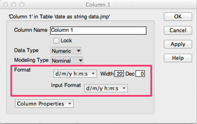

Back to the original question, I would change the data type of the column from Character to Numeric using the Format and Input Format to automatically convert the values to JMP Datetime values.
Then, if you want just the date part of the datetime value you can subtract off the time of day:
     :Column 1 - Time Of Day( :Column 1 )
-Jeff
