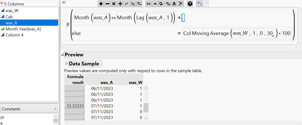

Staff
Re: Formula application
Hello-
I had started to make a reply and then noticed another post.  This may be an alternate...
notes:
The month function will return the month portion of any date/timestamp coded numeric, same as Excel Month() function.
The IF will check to see if the current row is not on the boundary of month-  this is set to  return a JMP "Missing", which may behave a little differently than an Excel NA() .
Since the values were coded 1 and 0, just did an average of next 30 rows rather than {Count 1/(count 0 + count 1)}.
When transitioning between spreadsheet oriented formulas and JMP data tables with formulas that act like Excel relative references (Lag, moving average)...
* examine the behavior at the top and bottom ends carefully to ensure intended operation*.  An Excel relative reference to "the row above" copied into the first row would return a #Ref! error, A JMP Lag(1) returns a missing in the first row.   Also look at the specifics of the JMP Rolling average as the number of remaining rows gets <30... (may be fine- just have your eyes open).  Can trap for this with an extra conditional in JMP formulas.. if (row()==1, special thing for first row, otherwise use lag function)
The description does not give rationale of the table design, but if the intent is to find the portion of 1 values within the current month and there is an assumption that there will be 30 rows per month sorted in order.... there is another approach that will be robust to # rows/month <>30 and row sorting...   With date/timestamp column A selected- right click>new formula column>date /time> "month year."...
then make a new formula column to find the "average" W for that month/year    Col Mean( :was_W, :"Month Year[was_A]"n ) * 100, similar conditional to find boundary row if needed
