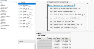

Hi,
I'm trying to write a formula that will check if the values in Column A & Column B are both over zero OR if the values in Column C & Column D are both over zero (and so on with many column pairs).  If at least one pair has both values over zero, I would like the formula to return 1.  If not, return 0.  However, the formula I wrote is returning all 1's... even in rows that have all negative numbers.  Can someone please tell me what I'm doing wrong?  Thank you!

This is the formula that I have that returns all 1's:
If(
(:A & :B) >= 0 | (:C & :D) >= 0 | (:E & :F) >= 0,
1,
0
Georg
Level VII
Re: Formula Editor
Dear @EH1
please recognize that ":A & :B" will always yield 1, if not at least one value of both is exactly zero. And comparison with ">= 0" consequently also yields 1.
