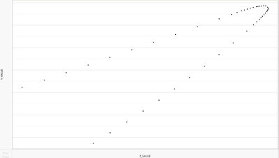

Is there a way to fit a spline to a shape in graph builder (or any other platform?)  I am trying to fit a spline to a set of X/Y data points that fall on the outside of an airfoil contour.
So here is the data

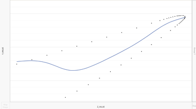

this is what the smoother function currently gives

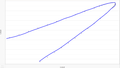

and this is what I would want  (the blue fitted line)

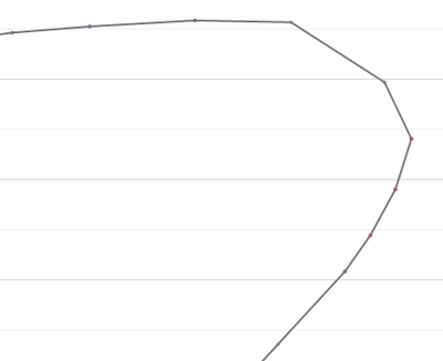

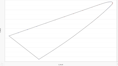

If I turn on the contour plot and have a value to put into color then the boundary line of the contour plot gets pretty close but it appears to be a linear fit between each point, which works pretty well when there is good hit density, not so much for lower hit densities.  Also, it is very sensitive to the alpha value so is taking a lot of tweaking for each vane.

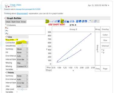

You ROCK!  This link
https://community.jmp.com/t5/Discussions/Bezier-interpolation/m-p/257852#M50666
had this buried in it and it works great!  I'm still going to try and learn the JSL way as well but this gets me what I need in the short term.  Thanks again!!
